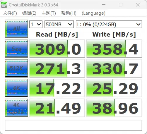

对闪迪带锁颗粒有些许研究,遂画了这个转结帖
理论上可以解锁所有1ce的s1,ndie
下面是1ce130die(272)硬解成1ce8die的测试图
A357=Sandisk,256Gbit,SDUNBIEMM-32G(bics3)(1C8die)(58XT)(CMDD5)
Sandisk,256Gbit,SDUNBIEMM-32G(bics3)(1C8die)(58XT)(CMDD5)=45,49,9B,B3,7E,72,4,16,1952,012288,0768,02956,02672,01000,02,008,01,1,42,00,0,99,7F,11,0000,A2,00,00,20,20,25,10,00,02,00,00,00,10,1C,060,2,0,02,04,06,FF,01,05,3,05,0001,0001,7F,11,01,00,00,00,00,00,00,00,00,0000,00,00,00,00,00,00,00,
由于只有1ch1ce,速度较差,回头贴满4颗再测一下
挂闲鱼了,想要的可以去看一下

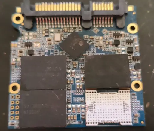

256G的盘还是太小,我还缺少59xt2的板子且转结帖太厚,遂换了个单面4贴的58xt想要贴4颗一起开;
焊接难度偏大,一波三折~~~~~
还有一颗颗粒炸id了(
最后贴了3颗开720G
颗粒频率ddr300(再高报adj,不知道为啥
成果展示(参数不变)
Total 3 Channel
Total 1 CE
Total 8 Die Per CE
2 Plane
Total 24 IntlvChNum
16K Page Flash
768 Page
1478 Block
gbsCardMode = 0x97
Enable Internal Interleave
Enable Interleave
8-Way Interleave
Multi-Die
Enable SanDisk Dynamic Read
货真价实的8die/ce 8路交错
可惜速度还是挺慢;
